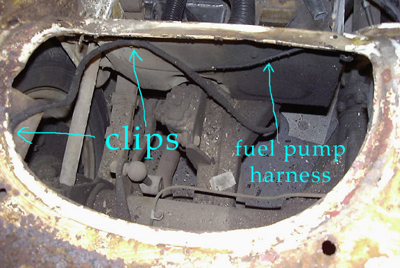

Can anyone tell me once the wiring harness makes it way down the frame to the rear axle where is it suppose to get atached to to? At some point does it attach to the rear heal board and then the bumper stop box on the drivers side?I have seen a lot of pics of the underside but none by rear axle. The "wiring expert" that tried to put mine in wanted to run it down inside the transmission tunnel from the front to the back of the car..... Needless to say he didn't finish the project.
Thanks for everyones help....
Yes Peter, you have described pretty much how it is to be routed. Perhaps others might have a picture of it for you.---Keoke
Hi Peter,
I know John has photos of his wiring harness, but I didn’t see them on his website. This is my BJ8, it should be the same. Here is a picture of how it was routed in my car.
