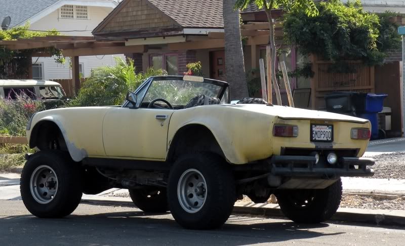

This guy with a Jensen Healey seems to have found the trick. :jester:
