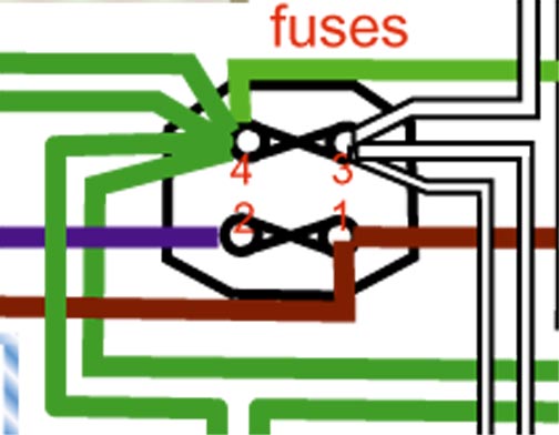

The fuse block on my BJ-7 haas a color coding problem. Looking at the wiring diagram with the headlights at the top and the taillights at the bottom of the diagram the numbering is: lower Right (1)- brown, lower left (2)- purple, upper right (3)- white and upper left (4)- green.
It also shows only 4 terminals.
On mine there are 5 terminals 2 at bottom left, & 1 at the other 3 positions.
I also have no brown wire or purple wire anywhere in the vicinity.
The way I have it hooked up now is lower left(double terminal)- green, lower right-green/black, upper left- white, upper right- black.
1) Am I looking at the diagram upside down?
2) Or was my block installed upside down?
3) Are my colors wrong, or right for this fuse block?

Whatever you do, don't hook up the battery. The white and black are + and - from your battery. At least with a stock wired harness. White is your switched hot feed. Green wires are hot feeds to components like turn signal, heater. They get wired to the other side of the fuse from the white wire. The brown wires are always hot feeds, purple is opposite the brown from the fuse and that's your horn.

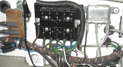

Hi Robert,
It's hard to know if you have the wrong harness, or it is routed incorrectly. You've used the phrase "not in the vicinity" in a couple posts so I'm scratching my head a little. Here is a photo of the wiring around the fuse block area if that helps. You should have a long section of harness that goes up front on the driver's left side to the steering column, then across the front and ending at the horn (purple & purple/black wires).

I have a few comments, having recently been through this wiring on my BN6:
1) According to the factory manual, the color wiring diagram is correct for the BJ7 and upside down in the manual and in the above posting. Pretend you're peering over the windshield at it. The factory diagrams are all upside down in the manual.
2) Terminal 4 actually consists of the one shown above and the one in the 6-o'clock position (12-o'clock on the diagram), which is joined to 4 by a sheet metal jumper - evidently they needed 2 terminals to hold all those green wires.
3) Fuses: 1-2 is 50 amp Lucas or 25 amp US ; 3-4 is 35 amp Lucas or 17 amp US
Also, GregW your car must be a late BJ8, because according to Anderson Moment's Healey Restoration Guide, that's the only car with a fusebox shown in the position of the above photo - the BJ7 and other models have it next to the hood hinge. The wiring on the BJ8 is a mirror image of the other models. BJ7 and other Healeys have white and brown supply wires entering terminals 1 and 3 per diagram above.

The photo of my fuse block is the original wiring. My dad said he never had problems with the electrical system, so he didn't mess with it. (He was the original owner.) If I was to flip the block around, the short brown and purple wires wouldn't reach their proper terminals. Plus the green and white wires would cross the block oddly. Maybe the guy who wired the earlier cars retired in '63? :laugh:

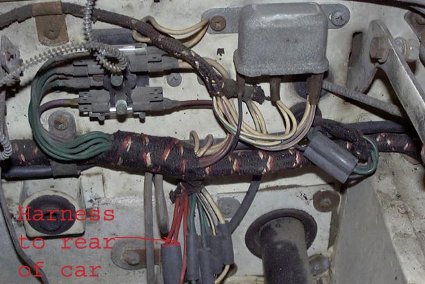

I'm not sure about the numbers, this is what my fuse block looks like now. :laugh:
