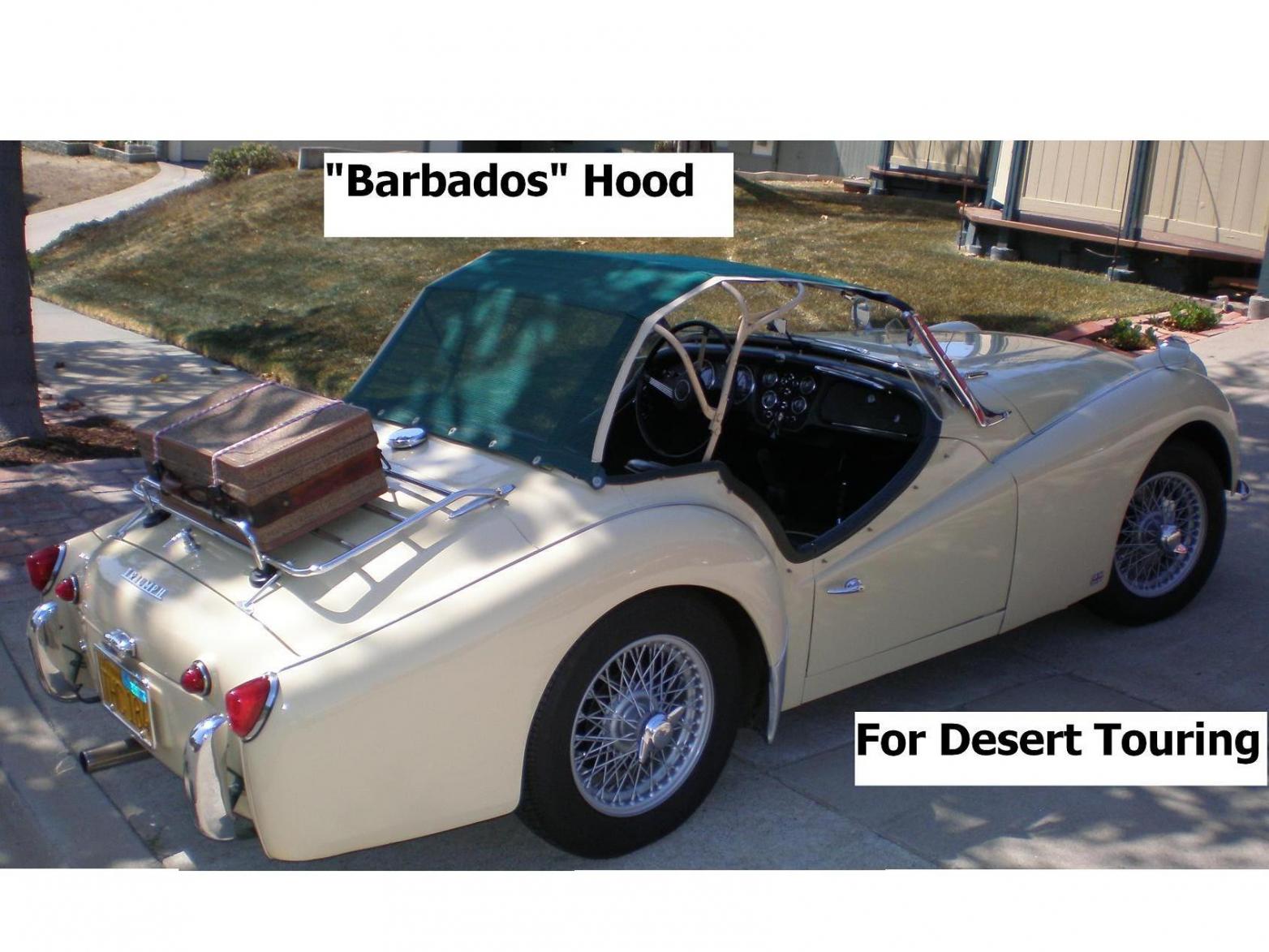

I made this one from Home Depot or Lowe's shade cloth. It comes in
different degrees of shade: I used the darkest. I used cloth-backed
vinyl for the front & back binding and rubberized cloth for the sides.
I was able to do the stitching on a regular home sewing machine.
If I had it to over I would make it wider so it would come a little
further down the sides.
Don't need to worry about a window; 100% visibility out the rear
through the cloth.

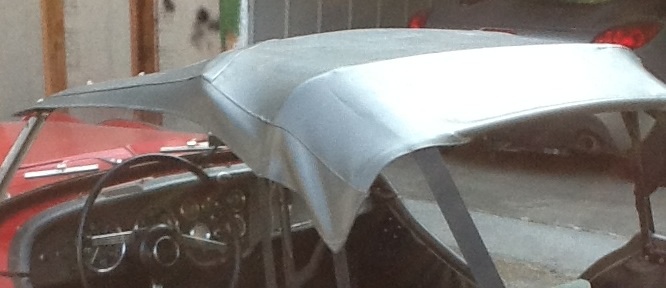

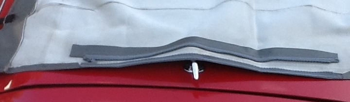

I will have to post picks of the one my wife made for mine. We have a zipper pocket that uses the rear bow for the rear attachment. Have two straps to pull it tight on the sides. We mad it out of vinyl. I will take pics and post.

Frank, that's a neat looking design? I's thinking of just having the top part so the wind blows freely through, but your design would keep the sun off your back if the sun is behind you.

Frank's may be the one I was thinking of -- great design.

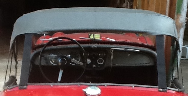

Here are the pics of my top. It is like having a top but being all open.
don

Don, yours is just what I had in mind. I was going to use my roll bar for the back, but I like the way you made the pocket for the rear soft top bar. It looks like yours is made out of a TR3 soft top, or the shape and seams are is similar to a TR3 soft top. How did you reinforce the front so the front would be firm and so the Tenax connectors would hold correctly? Also, did you use velcro on the back to make the pocket for wrapping around the rear soft top bar, and does that hold well while driving? Thanks!

The wife double the layer for the front and we used a zipper to make the pocket. I would not use normal Velcro. I like the zipper better than Velcro. Looking at it an extra strap on each side to pull it back is all that is needed plus the side straps.
Don, I assume you used Tenax connectors for connecting the front to the windscreen, is that correct? Thanks!
Regards,
Bob
Yes they are the same the my top has.
