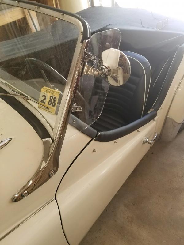

I have one flat mirror on the drivers side and find it almost totally useless as an aid to see behind me. I gather the original mirrors were convex.
I have a convex mirror mounted on the windshield support that works great. It is exactly where my eye goes to check behind me.I got it from Holden Vintage and classic UK
https://www.holden.co.uk
I can not comment on the Moss mirrors but I could not find any that matched the mirror that came with my car.

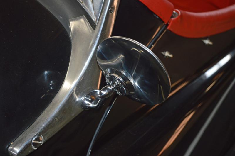

I have wing mirrors and both of them are convex. I had a flat one on the driver's side, but it just wasn't enough coverage, especially if it wasn't adjusted just perfectly. I also added a mirror replacing one of the stanchion screws (works only on post 60K cars) with a 'Harley-Davidson' mirror available on ebay. You need the right side. The threads on the mirror are the same as the stanchion screws, 5/16"-24, and will screw right in.

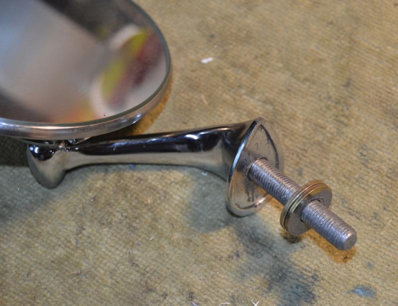

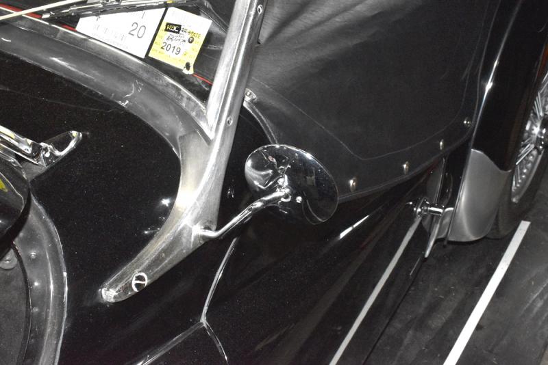

However, when I was riding around the other day, I decided that even though the Harley mirror is better because it is closer, I still would have preferred a convex mirror in that spot. So, I went back to the original set-up I had which uses a right side convex wing mirror. I cut the original stud off, drilled and tapped where I cut it off and inserted a longer 5/16"-24 stud so it would screw into the stanchion hole. I originally took it off because it was short and felt it might be easier to see if it stuck out farther. But, the Harley mirror, not being convex didn't work so well for me. Also, the threads on the Harley mirror are a bit undersized, 0.302" vs 0.308" or 0.309" that most 5/16"-24 hardware measures, and don't fit as well as I would have liked.
