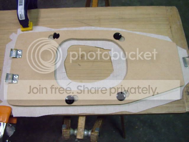

Kevin I went to one of the Boxstores and bought a 2X4 piece of MDO or MDF, I can never remember the difference. It is good stuff.
Here is what it looks like when I did my shifter for the Wedge.
I cheated and took it to my upholstery guy and he has the short staples
