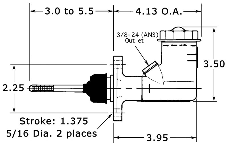

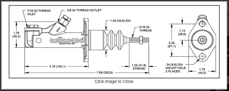

As Dave said, smaller diameter master cylinders require more pedal travel to displace the same volume of fluid as larger diameter cylinders.
Also important, some replacement master cylinders based on the Girling design can have shorter strokes than genuine Girling master cylinders. For example, the Wilwood GS master cylinder and other aftermarket cylinders only have a maximum stroke of 1.250-inches while Girling master cylinders have a maximum stroke of 1.375-inches. Sometimes, the additional 0.125-inch stroke of a Girling master cylinder is desirable.
