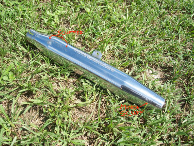

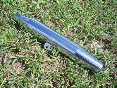

I have a similar set-up, but with a Harley "bullet" muffler (2"). If you have friends with Harleys, they love to take them off and "upgrade" them for the "fishtail" mufflers. I snap them up and use them! They are flow-through and they work GREAT! I have spares /bcforum/images/%%GRAEMLIN_URL%%/grin.gif
Ray, here are the pix.
