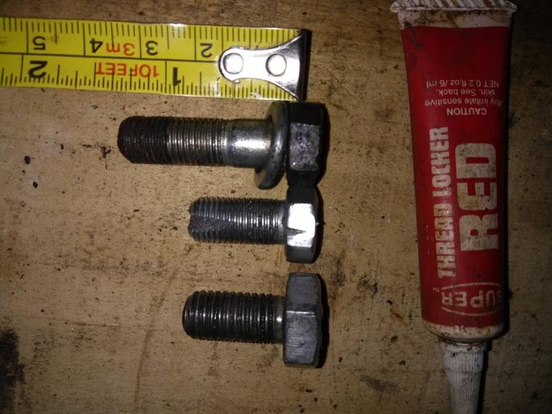

Reinstalling a rebuilt BN6 side change gearbox I discovered the PO had replaced the slave cylindar mounting bolts with 20mm M10 metric bolts which have now stripped out.
There seems to be plenty of space to re-tap with longer (1½"?) 3/8" unf bolts but has anyone had any experience/recommendations?

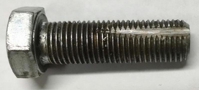

20mm seems short (roughly 3/4"). Maybe there are still good threads in the hole. You can make a chasing tap out of a 3/8-24 bolt. This one's 1-1/4" long:
Otherwise you might be able to loctite studs in the holes, or install helicoils.

A thread clean, then two longer 1[SUP]3/8[/SUP]" screws to replace the metric ones that had been forced in and a little loctite and the slave cylinder is working.
I'll get some helicoils too...
Thanks all!
