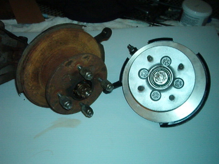

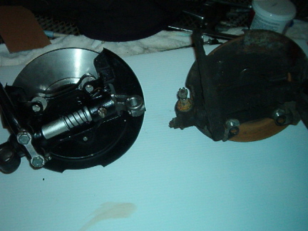

Well, we have one hub done. See the before & after shots.

What are you using to do that amazing clean-up job on those parts? Or are they new?
Me too, I wanna know too!!! /bcforum/images/%%GRAEMLIN_URL%%/iagree.gif /bcforum/images/%%GRAEMLIN_URL%%/lol.gif
Thanks for the compliment, the brake disk is new, everything else washed and repainted. Black is brake caliper paint but the silver (wheel hub) is my new favourite colour, Plasti Kote, Heavy Duty Fleet Care Paint, #21804, "Cast Aluminum" It makes the parts look brand new (especially those that were originally unpainted.)
We have a local store (KW Surplus) that has paint at about 1/2 the price of "real" stores. My wife mocks me that I just keep bringing home paint but it costs me $2.95-$3.95 a can for most everything I need.

Ah-ha!! really does make the parts look new! /bcforum/images/%%GRAEMLIN_URL%%/thumbsup.gif
Nice work indeed. I've got a set of disc fronts for my Bugeye that need redoing if you'd like to try a couple more. /bcforum/images/%%GRAEMLIN_URL%%/grin.gif
