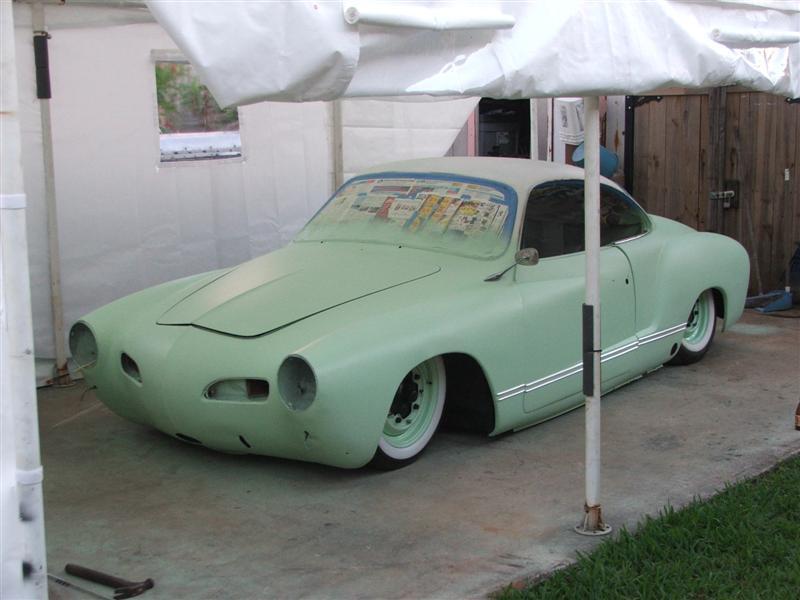

BTW - i'm sure some of you will croak, but I've found what color I'm going to paint my bugeye, while I sort it out mechanically..... It's Hot Rod Flatz Mint Green. I had orginally thought it would do it in either grey or black primer but this looks like more fun and will go great with with while walls and red wheels! lolol! Plus it's only $35/Quart! I'll shoot it in my garage.
here's a photo of a Karman Ghia in that color.

For me, that colour doesn't look a whole lot different from the original leaf green.
