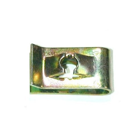

OK all of you BE Experts. A Front Turn Signal Socket takes a 6/32 Screw to mount it to the bonnet. Or is it a machine self tapping type of screw. And of course I will find them the day after I've bought new ones but I need the answer to take Bugsy Driving. Thanks.
The size sounds right (#6), but not a machine screw, rather a sheet metal screw and and speed clip that slips over the edge of the sheet metal.
Looks like this:
