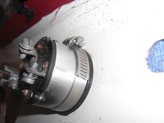

So I was so set to finish my instrument panel install tonight, but could not get the ignition switch to fit tight against the dash. I have a new/old stock switch, but not the spring clip. I thought I was going to use a small radiator screw clamp, but the switch is still loose. Anyone have a clip they would like to find its way to a good home? Or any ideas how to rube it some other way?

think you must have the correct clip.
This is what I came up with. Two rubber o-rings, with the small screw clamp (Moss)for the steering rack boots. The o-rings allow enough spring so the clamp fits tight and the whole assembly seems OK. We will see. A lot easier to change it now than later!!!!Dash install tomorrow!
