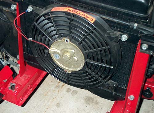

Here's how mine is mounted. Two metal straps. The fan is bolted to the top one, but held on by zip ties on the bottom, since the mounting holes don't line up. I've been meaning to fix that, but haven't gotten to it yet.
The straps don't have to go all the way across, of course. As it stands, they block the radiator a bit, which is less than perfect. There are lots of obvious alternatives.
It's a 10" diameter fan. The controller is described at https://www.nonlintec.com/sprite/controller/ and you can see how the sensor is mounted.
