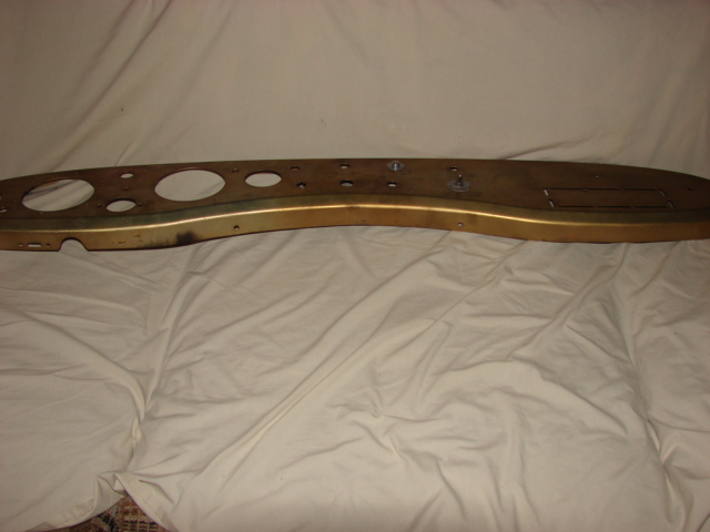

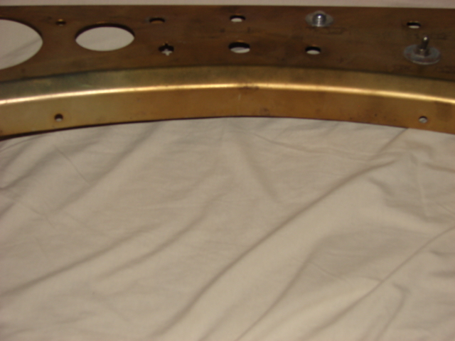

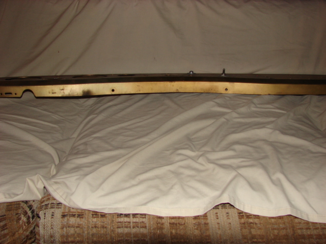

Recovered my BE dashboard and fitting it now into the dash. Does anyone have a picture of a stripped dashboard?
I can't feel through the vinyl the screw openings at the bottom of the dashboard. No problem with the two on top (one on each side) but can't feel the bottom ones.
Anyone have a picture of can give me an idea of where they are?
Does this help? You can see one of the holes in the photo.
Bruce,does this help?? I figured I may as well do it now, rather than leave you in suspense!! /bcforum/images/%%GRAEMLIN_URL%%/grin.gif

This board is incredible. Thanks guys. I can see one Drew, and if Jeff can get the other...I'm in fat city.
Drew...great article on finishing a dashboard...followed it step by step.
Whoo...just saw Jeff's photos. Freakin Fantastic...WAHOO.
