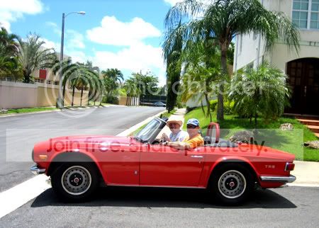

A very nice 6 hours spent with Ian and his wife today.
Breakfast at a local panaderia and lunch at out favorite
burger joint in the Old City. Best blue cheese burgers on
the island.
Ian and Dale took the Crypt Car out for a spin and sputtered
around the hood. Made it back without totally breaking down.
