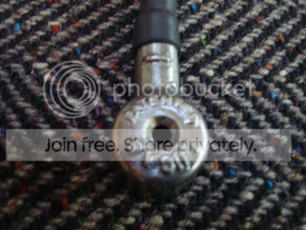

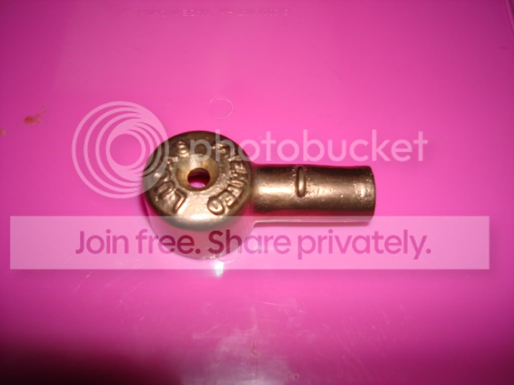

John_Malinick said:Word of caution! When installing the helmet heads on the battery terminal,you will have to drill a hole into the battery post for the screw. These are made of lead and very soft. Use a dull drill bit as a sharp bit will catch very qiuckly,bind,and snap leaving the broken bit in the hole. Beware.
Adrio said:I remember something called "liquid tin" from back in university during the time of dinosours. If that stuff is still around it might be simpler than tining with a torch.
