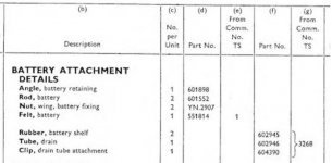

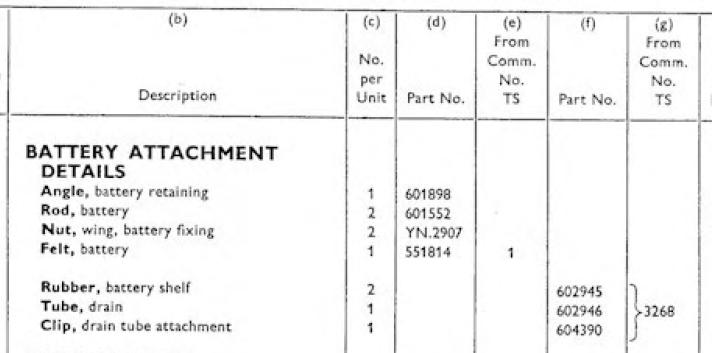

So I went out and bought a battery for the car today and I'm bout ready to stick it in there and see if the engine will crank over wothout making strange noises. I was looking through my listing of spare parts and I found a listing for battery felt and battery rubber. The rubber was where it was supposed to be but I don't have any felt.
My questions, what kind of felt? Does it go under the battery or under the rubber pcs? I didn't see anything in Moss catalog but there is a listing for both items in the Stanparts catalog.

I don't know what listing of spare parts you're referring to. But I'd guess that the rubber and felt are pads to go under the battery, on the surface of the box. Rubber on the bottom; felt above that.

Rubber strips sit on the bottom of the battery space and I seem to remember round felt "donuts" that slipped over the battery terminals and under the battery cables to reduce the dreaded white corrosion. Any one remember these from JC Whitney days?

Gordon - that's why I was hoping we'd get more info about the "spare parts list".
I'm guessing he is talking about the factory "Spare Parts Catalogue".
https://goo.gl/qPVao
