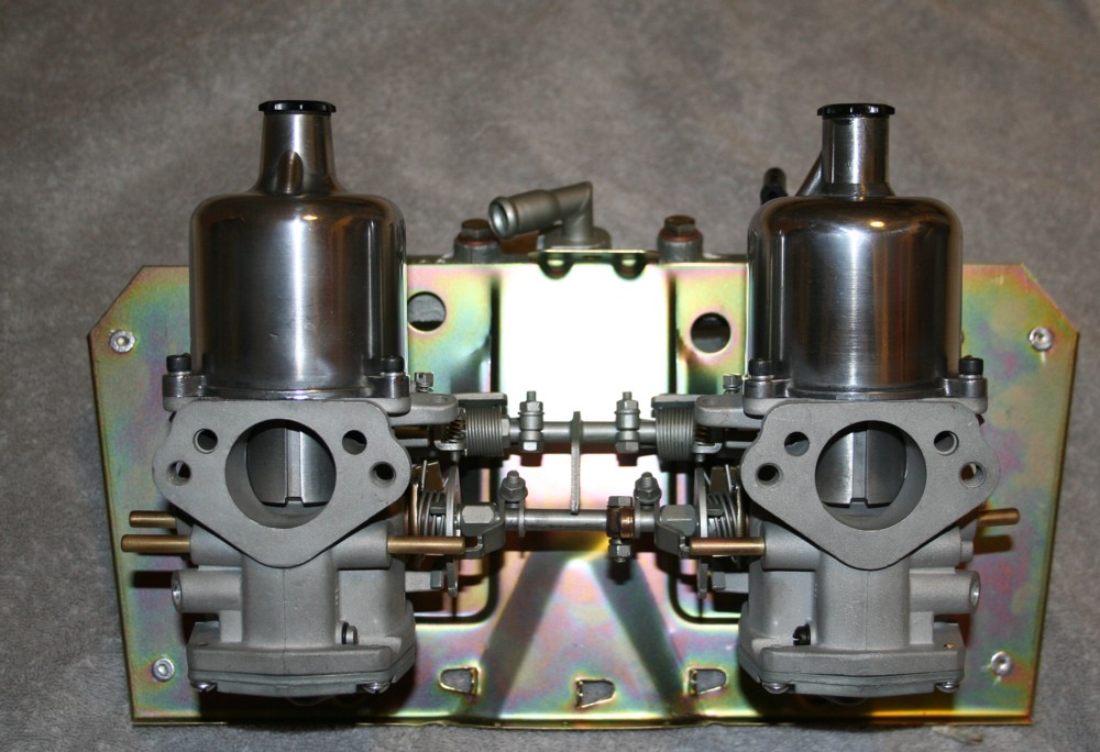

I rebuild alot of SU carbs, and polish the dashpots. I first clean the aluminum with hot water and soap, then I start with 180 grit sandpaper to get the imperfections out, than work my way down to 400 grit and wet sand , then I polish with a buffing wheel and white rouge, then finish by wiping down with a soft terry cloth.
My oh my Hap. Right from the factory. They are lovely.
When you get the surface smooth, it's very hard to beat the high speeed buffing wheel and beeswax for a really glossy shine. And it's very kind to the surface.
Just a quick caution for anyone buffing the dashpots .. don't let them get too hot. I've read stories of people warping them during buffing and the pistons don't slide like they are suppose too. But you guys probably know that.
