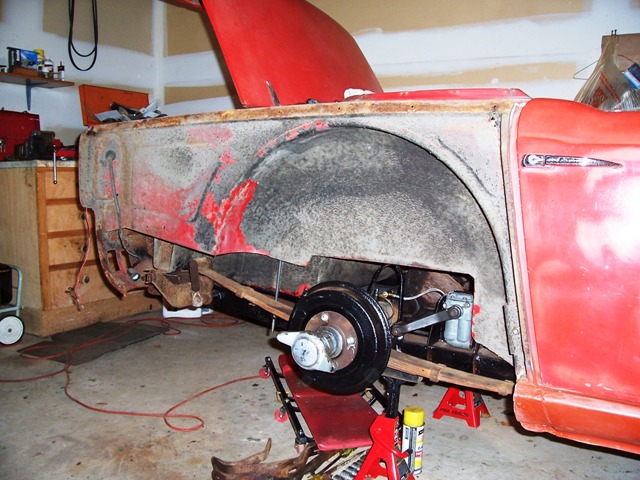

Having driven the car for the last month, it went back up on jack stands for the winter. I finally got to the last unknown area of the car - the rear inner wings. There is always a concern that the saddle area has rotted away under the wing joint, so I had to know before deciding on what the winter project would have to be. This time all looks good (pic attached) with only surface rust that should clean up well. The B-posts are also solid. The undercoating seems to have done its job over the last few decades. My only area of concern is trying to contain the surface rust that is on the inside of the rear lower valance, as it is a very tight area to work in.
I may have mentioned before that this TR4 is in better condition than the one I had over 30 years ago. The fun continues...

I'd get some POR-15 chassis black and take a Saturday to paint over that rust.
Good stuff...and you'll never see that brown stuff again...

Take a good look at your undercoating. After so many years it can get hard and separate from the metal. It will then work against you by holding in the moisture and contaminants that it originally was meant to keep out. I found many of these areas on my TR6 during restoration.
Another product on the market similar to POR 15, but available in most hardware stores, is Extend. It is water based(easy clean up) and very easy to use. Just follow the directions. It dries to a black finish and can be used as the top coat or as a primer. It works in the same way as POR 15 in that it chemically converts the rust into a very tough, durable finish.

Doug..I may be wrong but POR-15 isn't a "rust convertor" but a high-solids epoxy that simply "encapsulates" the rust, sealing out moisture and oxygen, and won't allow it to spread or return.

I agree with you about the undercoat, so I have already started to remove it and will re-apply fresh when completed.
While I would like to blast the rusty areas, I have had to take the following approach. After using a wire wheel, I have been using the Eastwood rust converter followed by their rust encapsulator. When I did some of the frame I also top coated with their new chassis black. I plan on using the same approach and time will tell. I will just have to do the best I can behind the valance.
