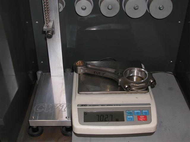

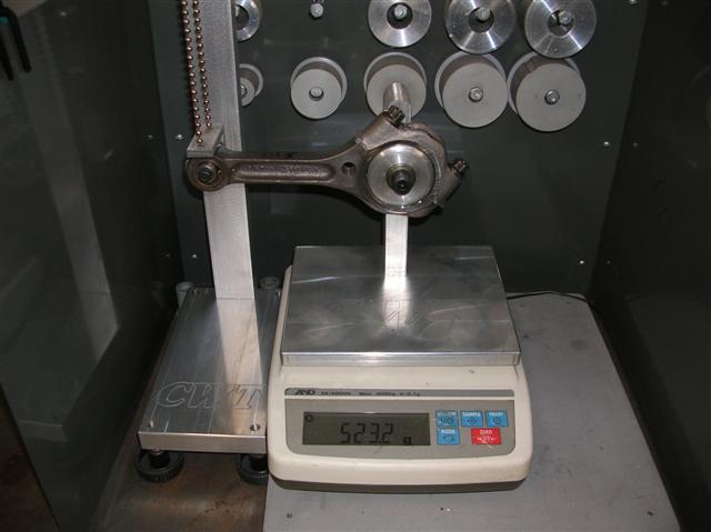

Doug,
This is how the machine shop did mine. Two separate measurements, both as stated above.

Paul- Understand the bottom one, What's the top one measuring?
Big-end mass. It's pretty important to have big-ends, given they're rotating masses, match. Even if overall rod weights are the same, you'll have balance issues if you have one eith an extra-heavy or extra-light big end, say.
In the past I have added weight to a rod - maybe an extra washer under a big-end-nut, or occasionally a little solder inside the "H". Be careful with tinning though!
