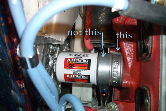

When you order a new gasket, just go ahead and order a spin on filter adapter. They are not expensive and you will eliminate the problem. Much easier to change the filter, cleaner too.

I think I'll go for the spin on adaptor. Does it replace the entire current assembly? So do I remove the two bolts going into the block? Then bolt on the spin on? If it doesn't replace the entire assembly, I don't think it will resolve my leak issue.

Hi Steve,
Yes, the spin-on filter adapter replaces everything up to the block. Here is a photo of mine. The “not this” is the oil cooler sandwich plate that is additional. A good filter would be the K&N 2009.
