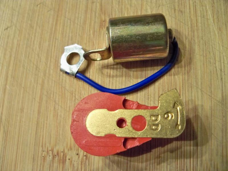

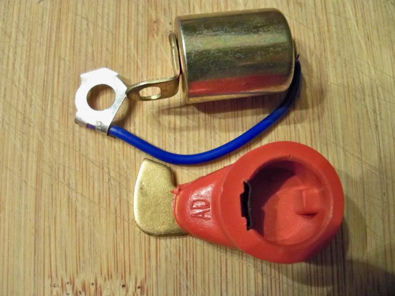

I'll say one thing about TRF and the 'red rotor' for a TR6 distributor "They have their bases covered"
As part of an order I ordered a spare red rotor from them.
These are pictures of the one and the same red rotor that I was sent....as well as the so called 'just as good as the DD" condenser
'.....like a box of chocolates" ?
Given my poor experience with repro parts over the years, when I do a tune up I clean and bead blast everything and then inspect visually and with a multi-meter. If it checks out well, I don't even think about replacing anything anymore. I bet that even my plug wires are 50 years old, but the insulation is intact and they still resistance check fine, so they get put back in every fall. The fact I can get away with 50 year old electrical parts is a testament to how much better they used to be...
The blue wire condenser you show looks exactly like the ones I got from British Vacuum Unit@8.95 ea.
TRF no longer carries DD rotors for the TR3,not sure about TR6.
Looking at my red rotor that Jeff at Advance Dist. installed and the DD pics the trademark stamp seems the only visible difference.
