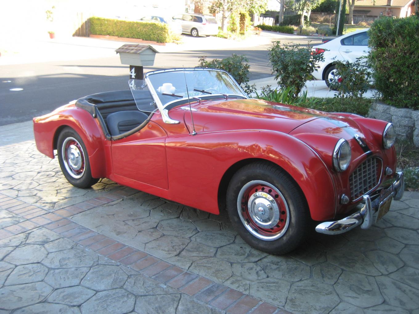

Finally got the TR3 back after several months in the shop for engine rebuild due to a broken crankshaft. Runs like a new car...and no oil leaks...totally un-LBC.

Very nice Red.
Now drive it like you stole it till some oil does leak!!

Red- Still too early to quantify that result.
Hey RedTR3
Did my brother just text me a photo of your car parked in front of the Concord Clayton Safeway? It's gotta be the same one!
Pat
Hi Pat...Yes, that was probably me, I was there this afternoon. You and I spoke spoke a while back...I live in "The Crossings", close to where your brother lives. We are frequently at that Safeway. Maybe we can meet up sometime when you are down this way.
Tim
I agree, drive the heck out of it - great looking car.
