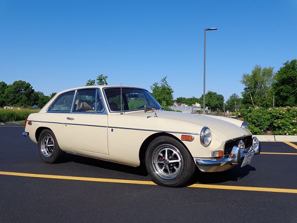

Well after a several year absence I'm back in the MGB fraternity. Recently purchased a very clean 71 BGT in Bedouin beige. It has AC that works OK, but needs some attention. Overall the car is in excellent condition. My thanks to the previous caretakers. My question is the car has the twin SU carbs and I'm a big SU carb fan. Really don't want to do a Weber conversion, but when you engage the AC it would be nice to have the RPM's click up w/ the compressor. Right now you need to pull the choke out a bit. Has anyone installed a vacuum or electronic throttle solenoid to kick up the RPM's. If so any pics/suggestions would be appreciated.
Thanks

no advice but, welcome home, great looking car and one of my very favourite colours!
