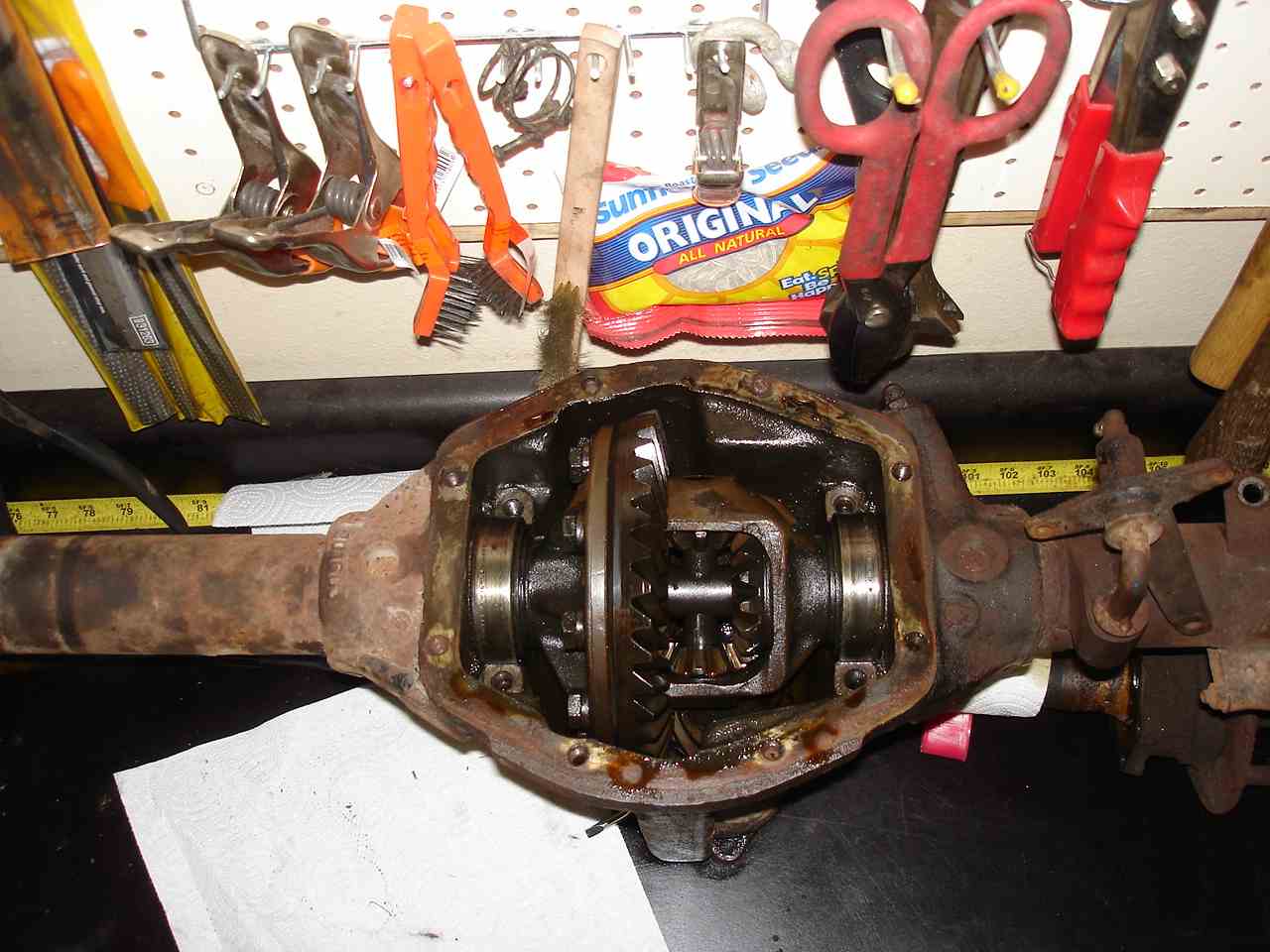

Anybody have the axle housing spreader referred to in the manuals???
So how, in the real world, do you remove the carrier once the axles are removed? Mine seems to be in there pretty good, I thought I would be able to pull it right out by hand once I removed the bearing caps. I ordered a Southwick axle from Jack Drews, and I need to prepare for its arrival.

In fact, I don't have the diff spreader, but have seen homemade ones. The illustration in the manual is really useful for that. It just needs some welding up, and then care in use not to overspread the diff and crack the housing.
The spreader is not totally mandatory, from what I understand, but makes the job one heckuva a lot easier. Personally, my idea of differential work is to take the whole axle assembly to a specialized shop and get them to set it up for me!
