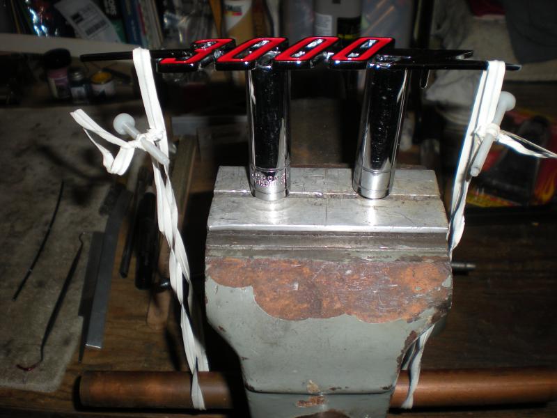

It it imperative to bend the script and arrow to the contour of the car. Be careful. The arrow wants to break off. Once you bend it, you can use the enlarged clip to hold on the hard to reach pin and it will stay put. If you do not contour the script first, it will have too much spring and the pin will pull free from the enlarged clip.

Hi Bill, I believe you are referring to the "3000" motif. And you are quite right. Understandably, I am dealing with this emblem as well as the script. The attached photo is of my make-shift bending jig. I'm using a heat gun as I gradually twist in more tension. I'm several days in now as I work towards matching an insulated wire that I shaped to the trunk lid..............dm

I also massaged the "curve" by using a piece of wood in a vice and carefully slid it back and forth with some slight hand pressure.
