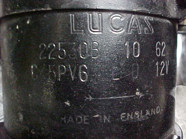

thanks for the info there, i think mine is a refurbished or new model as it doesnt quite match the ones in the photos given here. This is compounded by the plate on it having all the details scratched off it. Ive uploaded some pics of it and was wondering if anyone could recognise it. I would be immensly grateful.
Doesn't sound like a Lucas Generator. They don't have any plates on them for markings. They're stamped into the housing.
Slap's photo is indeed an alternator, not a generator. That should be pretty standard Lucas stuff, nothing really unique to an Austin. The very early Lucas alternators used an external control box. Shortly after that the more common and current design with the integrated controls came into use. I suspect that's what you have.
If you google the topic of "alternator conversion" and use additional keywords like "TR6" or "MG" you should come up with a wealth of articles on how this or that alternator can be adapted to various British cars with an explanation of what the various alternator wires connect to. Most of those links will have photographs showing the rear of the alternator to help you identify which pins to use.
I would first try a local shop that repairs starters, alternators, and generators. There isn't much difference repairing a Lucas generator as other brands. As long as they can get the right brushes and bearings.
