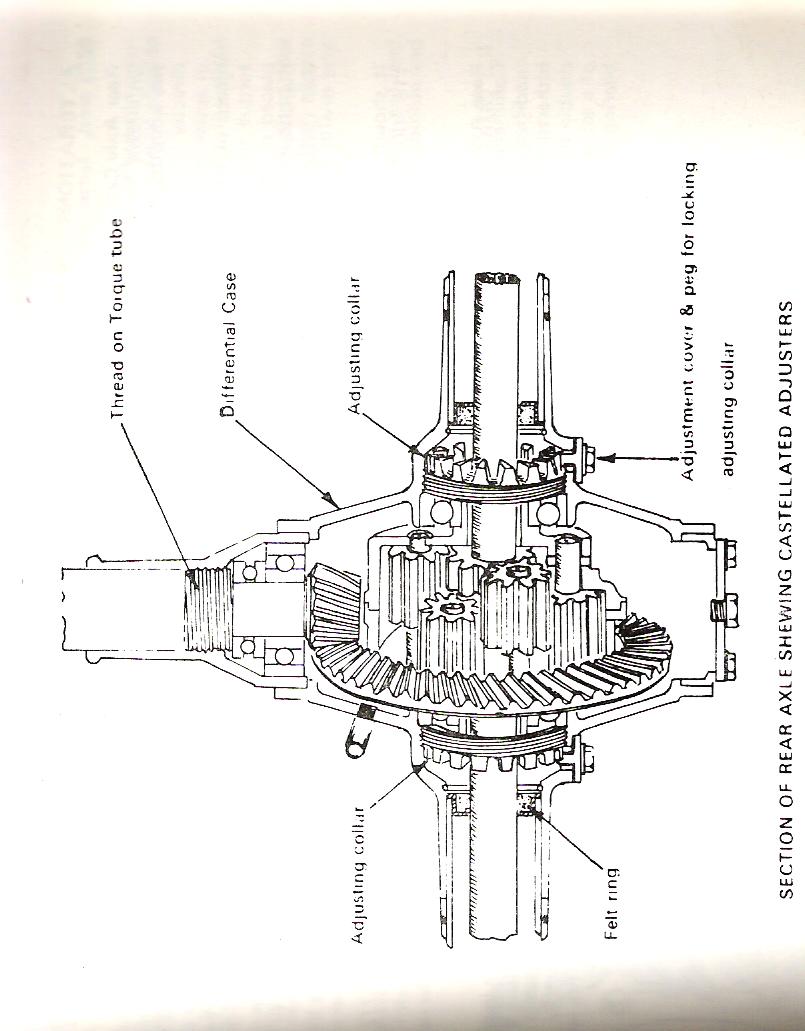

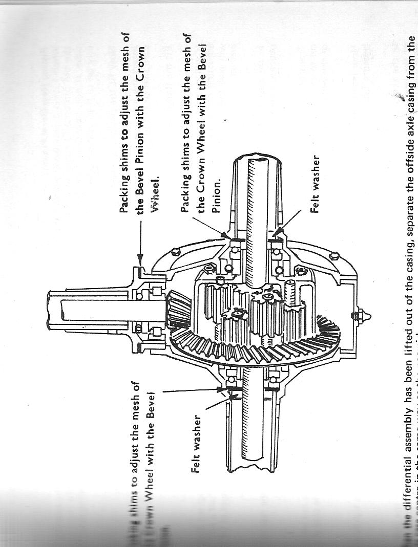

A7 Diff drawings
I have attached drawings of two kinds, though the actual diff mechanisms are similar in both. I hope these are what you need!

Roger - that's exactly what I needed. Thank you! The overall design is what I hoped we'd see. I'm impressed by the layout - very compact and apparently very strong. This is a big help.
