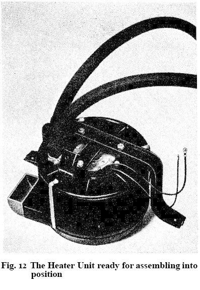

I am in the process of restoring my dash and fascia panel; while the fascia panel is out I thought I might install the heater that I’ve had for a while. It seems that there is little to no room to attach the hoses to the inlet and outlet of the heater maybe an 1 ½ but no more than that. Looking at the heater the inlet and outlet is to the right as is the air outlets that go to the vents. Any hints would help.
Assemble the mounting bracket to the heater, then the hoses on the heater, then install the assembly with the hoses attached. Page N13 in the workshop manual.
Mine is setup like the photo, when I try to get the heater in position the hoses do not allow me any room to attach the front bolt on the bracket to the bulkhead. There just is not enough room!
<span style="font-size: 12pt"><span style="color: #003300">Randall's picture from the Bentley Manual shows the layout of the hoses but needs to go one step further. Item 7 in the instructions "Remove trimmed glove casing after the withdrawal of the 4 P.K screws". There appears to be a slight editing oversight here. Translating that instruction to "American" means...<span style="font-style: italic">Remove the glove box !</span> On page 14, instruction 17. states "Replace the trimmed glove box casing" (Now #7. makes sense.) Bottom line Russ, Remove the glove box & it becomes a simple matter to install the heater!!
FRank </span></span>
Good point about the glove box; I tend to forget since I've never had one.
But JIC, there should be a stud on the front of the bracket, it just pushes through the hole in the bulkhead. There really isn't room to get your hand in there, or even see; just move it around until it hits the hole then either have a helper start the nut, or jamb a piece of wood under the heater to hold it in place. If your stud has somehow been replaced by a bolt, you'll need to find some way to anchor it in place.
Headway, I have the heater in place attached via stud to the bulkhead with the hoses on the inlet and outlet attached. Now just attach the air outlet hoses to the vents. Sweet as always a big thanks to the BCF family, why I say family is because you’re always there to help. Removing the glove box was the trick!
