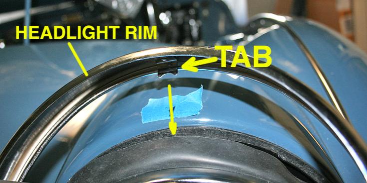

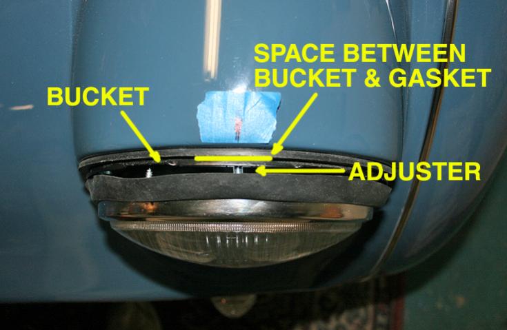

OK, another TR3A headlight snap on rim question, why is this so difficult!
Anyway my question is does the tab and ring go go between the bucket and the gasket or does the tab go in front of the bucket and the rim hooks over the bucket,
A couple of photos attached, if it goes in front looks like the tab should be bent forward to get some room for the rim to go over the bucket.
These are new headlight kits from Moss replacing mismatched worn out lights.
Cheers,
Colin
1961 TR3A TS/81208-L-O
On the originals, there is a cutout in the edge of the bucket, where that tab fits. The photo I posted above shows the gap, here is what the tab looks like with the ring installed
I'm not sure I see that gap in your photo. If it's missing, you might be able to add it; or return the parts to Moss.
