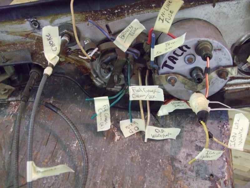

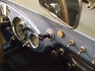

Hello Jersey, I think your talking about the chrome oval that goes just around the main gauges on the driver's side. I tried to find some pics of mine when I had it apart some years back and I only have two that might give you an idea of what you need. They aren't good pics but i hope will help. On the pick showing the back of the dash in the center top you can just see the two pronged clip (appears black) which is stuck thru the whole and bent over to secure the chrome ring. the other pick just shows the front of the dash and the holes for the clips. I did not re vinyl my dash preferring it to be body colour. Maybe clips could be found at a hardware store. hope this helps some.

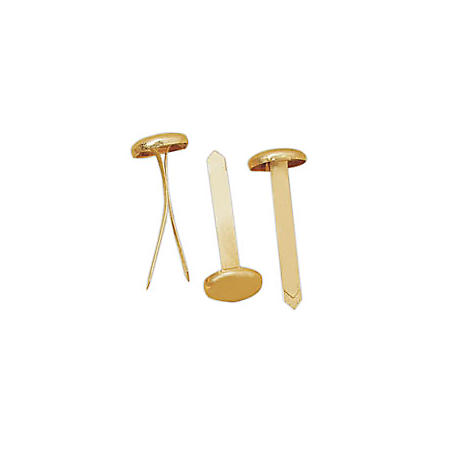

Jersey, did you use the brass paper fasteners? Or did you find something stronger?
I pulled my dash and glued on a nice piece of leather fromJohn Skinner. I don’t have the original clips that hold the Chrome dash ring inplace. The brass clips aren’t strong enough to hold the chrome ring tight to thethicker leather. Is there a stronger clip option? I could try to use contactcement on the backside of the dash. Glue the clip ends to the aluminum? Does anyone know of other options?
