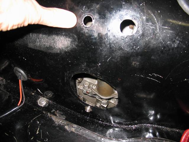

Spoke to a friend today about the cost of rebuilding OD's. The costs are escalating because of the difficulty and expense in acquiring replacement parts. Don't expect things to get any cheaper.
Check the wiring diagram from a shop manual. They often have an OD diagram included.

Hello Sam,
coincidentally, I have just dismantled an overdrive solenoid to fix a non operating pull in coil switch (internal). The solenoid wire is easily replaced with a soldering iron.
I'm assuming that your three has an 'A' type.
Alec
