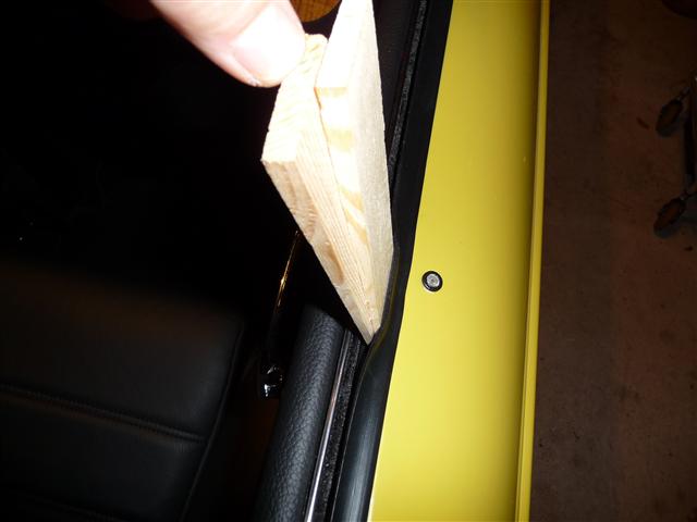

Skip............I just did the inner and outer a few weeks ago with the TRF seals and the clip tool with little problem.
For the inner fuzzy seal I used the tool to pull all the clips up into place and then I used the tool to hold each clip in place as I pushed the seal down onto the clip. This was different from the tool's directions but was very fast and effective. For the outer seal I wedged the seal in place, held it down with my finger and then pulled the clip up over the door lip and seal. I used wooden wedges to hold the outer seal in place and the make room for the tool. And you do want to remove your door panels as you will drop multiple clips down there!
