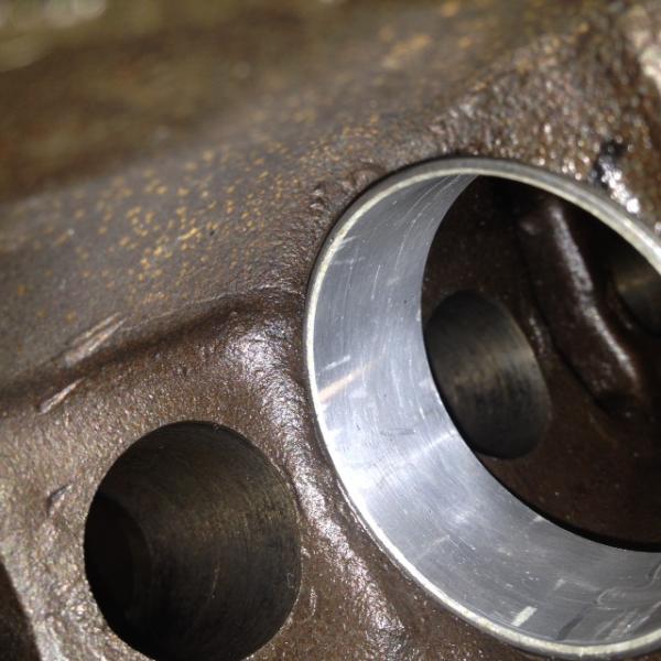

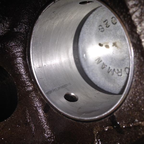

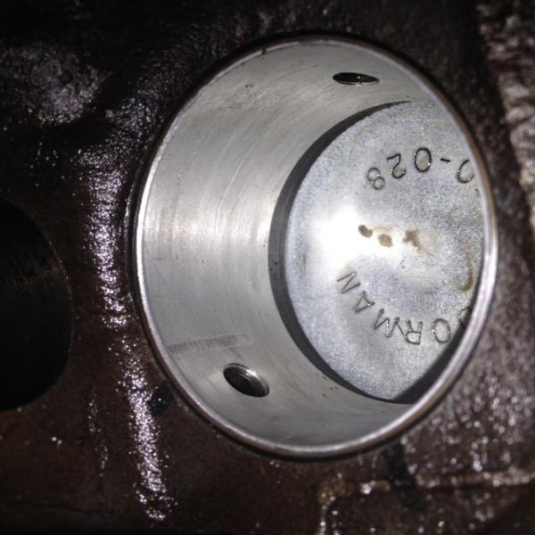

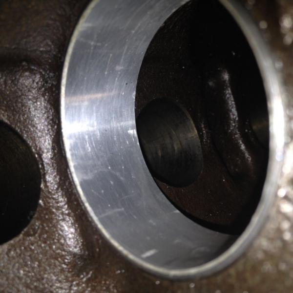

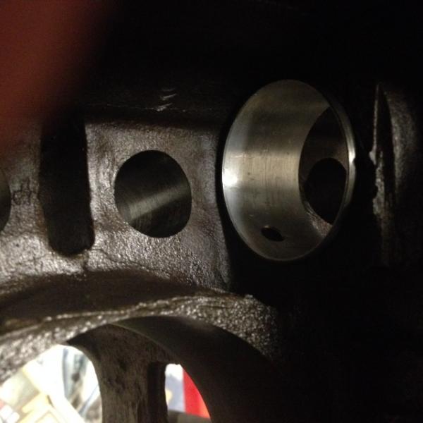

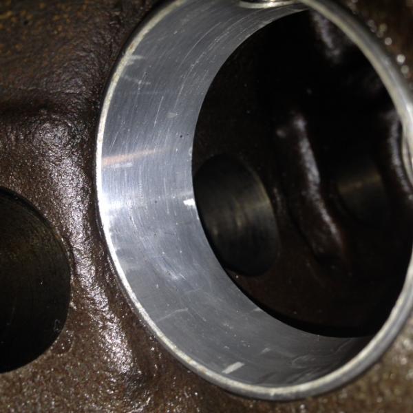

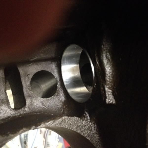

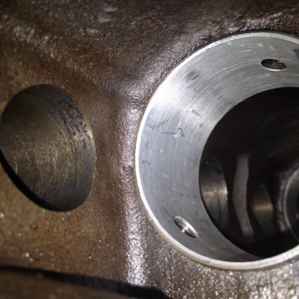

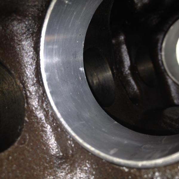

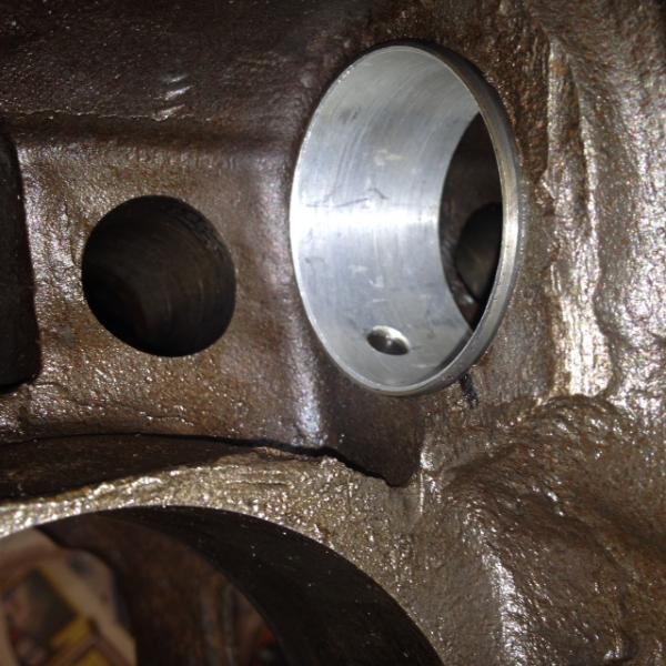

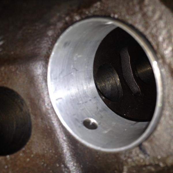

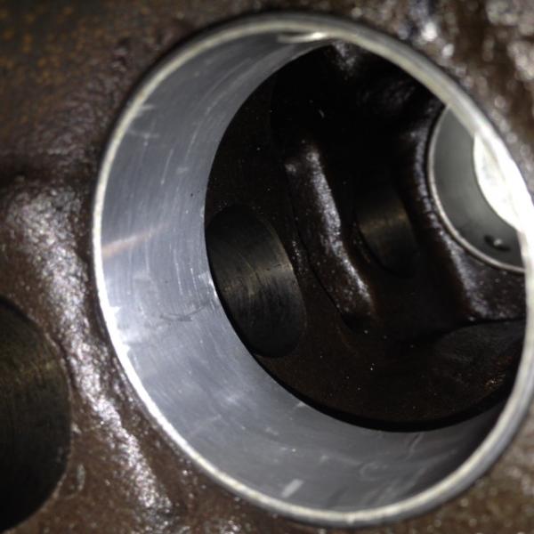

The pics seem worse, but the bearings really do look nice and smooth. Only the first one has any kind of abrasion that I can feel, and even then only slightly. My records show that a new "S2 Cam" was installed by Ken Gillander less than 25,000 miles ago and I'm inclined to think the bearing were replace then.
What do you folks say. I'd sort of like to start reassembling over the Labor Day weekend, but if it's unwise I'll order new bearings and have them pressed in.

They look OK to me. Ideally, you would measure the clearance, but that's kind of tricky and takes special tools.
