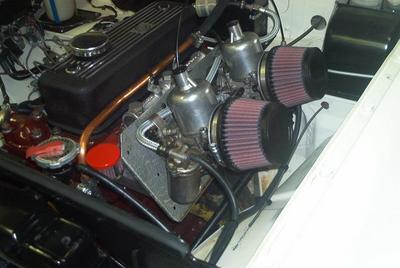

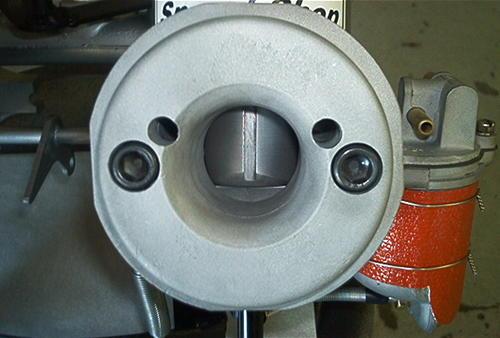

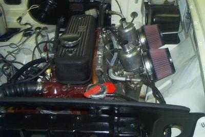

What about this, and just ditch the cans

Dave, that's exactly what I'm considering. I want to retain the original look, so I may cut open the bottom and install a thin mesh, then replace the inner elements with something better. That should increase breathing significantly. it would also be invisible to onlookers and these parts are in plentiful supply.
That's what I did - thanks to Hap!
It seems to make a difference on my engine.
Cap head 5/16-18 and are the K&N press on? Do you have a source Hap? I am not looking for the stock look on this B so better breathing is all I'd like.
I got mine at a place online for about $50 shipped.
You should countersink your holes in the original stacks & use the recessed bolts. The filters press on and then they have big clamps. The fit is just right. I'll look up that site and put it here in a minute.
