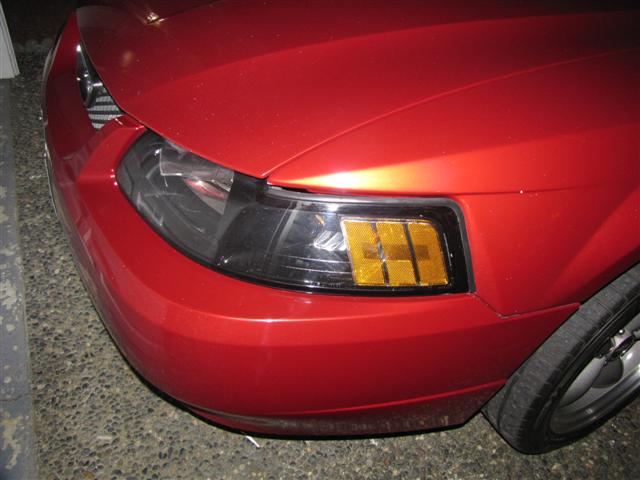

Also did my 02 Mustang. They where a little more money,also manufactured by TYC and fit as oem.

just looked up the cost on the Mustang units $47.00 each purchased May of this year.
