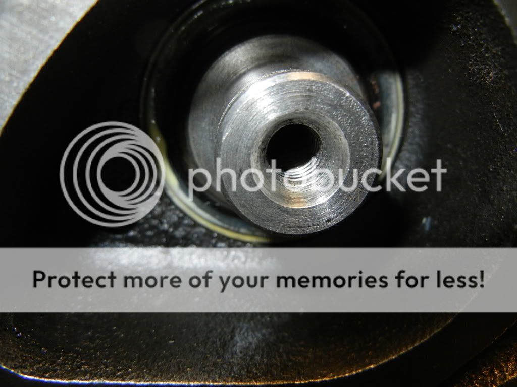

It comes to my attention that the apt(vp11 i think) cam i have for an 18v rebuild needs a plug installed in the rear. Instructions i have state that the cam has been gun drilled to provide better oil flow.
can any one tell my the type and size of plug required? the cam did not come with one.

Now the cam i have VP11 did not come with a plug to install in the rear of the cam. My question is what size is the plug i need to install?

Yep, I would call Dave, but I'm pretty certain, the above only applies to the APT A Series billet cams, which has oiling holes on the cam lobes, the APT B Series billet camshaft does not have this feature, meaning nothing to plug, I'm buildng a MGB motor right now with tht same APT VP11 billet cam, and use these cams several times a year, in my customer rebuilds.
Just afollow up on this, sure enough APT has the gun drilled warning on the B seires cam card. I'm doing a MGB engine with a VP11 billet right now, this gun drilled warning does not apply to the B series billet cam, only his billet A series cams, they can do that with the A series as far as gun drilling cam and have oil feeds to the cam lobes, because the A series engine drives the oil pump off the rear of the cam, but this is not the case in a B series engine. I've got a new VP11 billet cam here right now, and it is simply center drilled front and rear for mounting the cam on the grinder, no plugs. Now don't take my word for it, I wouldn't take some guy off the internet word either, call David, but he will confirm this, in short for this to be on the B series cam sheet is a typo, heck I never even noticed and I use APT B series billet cams probably 6-7 times a year in inhouse rebuilds, time for ole buddy Dave to clean up the cam sheet, but atleast they do give real timing specs to work with, I'm a firm believer in the quailty of their cams and lifters.

Just to wind this up. there is no gun drilling in the cam i have (vp11). The rear is tapped for something - but it is a blind hole. should be good to go.
Yep thats there for machining/grinding purposes. I used 2 APT cams in MGB engine rebuilds since this thread started :smile:
