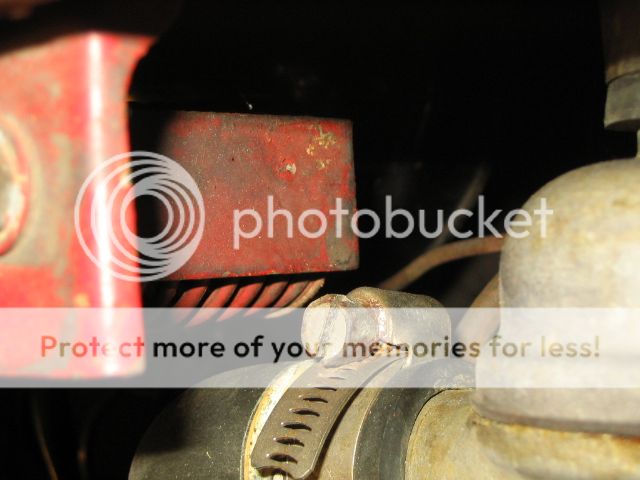

I am finally getting the apron on the car but I find that the hood latching assembly is hitting the by-pass hose. I did pre-attach the hood latching assembly to the apron before mounting it on the body. Maybe not a good thing. The latch spring is hitting the by-pass hose.
Your thoughts and suggestions on what to do next would be greatly appreciated.

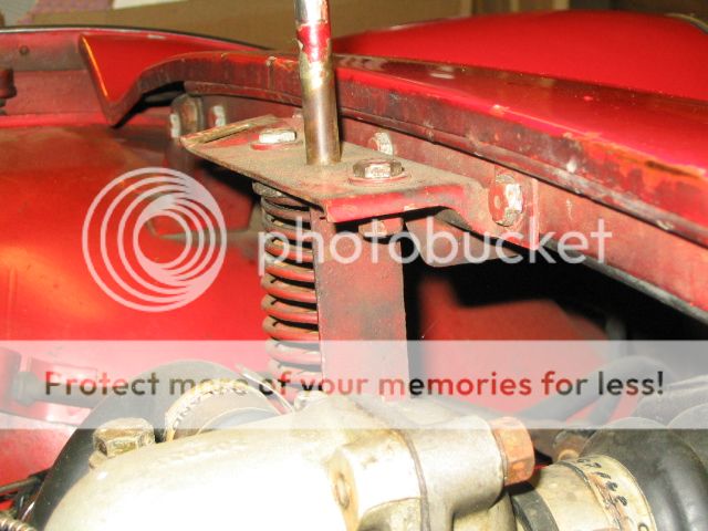

Mine is very close to the hose 1/8". There is some adjustment in the bracket where it mounts to the apron support bar. Does the pin on the latch assembly line up with the hood ok? It needs to go into a small oval shaped hole in the hood. You may be able to bend the latch assembly forward enough the give the needed clearance.

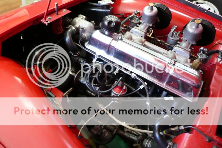

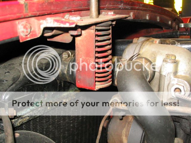

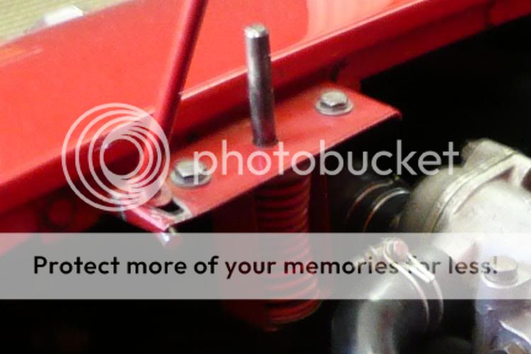

Something's not right. I have about a half inch of clearance there. Here's a couple of pix that may help you compare the postion of the rear edge of the apron, tstat housing etc to try and work out what's off:
Geo beat me to it!
If you look at the band that retains the spring, you will notice it "leans" a bit. I bet you assembled it leaning in the wrong direction. Or, you may have done what I did and bent it straight...and later realized it is supposed to be crooked!

Dick , CJD is correct , the spring holder is bent so it will lean and it looks like its installed backward. Undo the 1/4" bolts and rotate the holder , it should fit. Ran into the same problem with mine.
