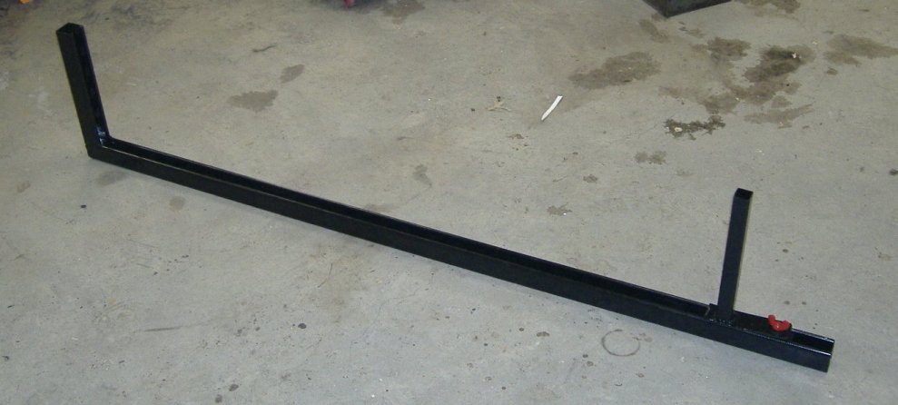

One problem with the Moss or HF tool, you loose accuracy as the position of the tool is not well registred in relation to the wheel or tire, it's sort of up to the user to say if the arms are touching the tire correctly. I was taught the string method yesterday and it worked great, but really takes a couple of people and won't work on a car with a differnt track front and rear such as a Midget. For single person use I made up a gauge that I can use by myself and it will work on any car. Just check like points at the front and rear of the tires and compare the readings to get the toe setting. Mounts under the car so there isn't a clearance issue. Just slide it in place, tip up and adjust, then repeat on the other side of the tire. You can make a similar gauge from scrap wood or such as well. That and a tape measure or ruler and you're in business.

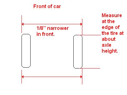

WOW! My head hurts from all this information. So the string method will not work for Midgets, the above contraption needs to be fabricated, correct? I haven't seen the yard stick trick described yet. Unfortunately, I have limited time to spend on my car, so I'm thinking it's best just to drive it to a shop and let them deal with it! CAN THE SHOPS LIKE FIRESTONE/GOODYEAR, etc. ALIGN THESE CARS?
Yes, any of those can do an alignment. But remember you're paying full price and the only adjustment you can make on a MG is toe in. It's just so simple to do at home and save yourself 50 or more bucks. Basically all you need to do is compare the width of the rear edge of the tire at axle height with the front edge. For a B or Midget the front should be about 1/8" narrower than the rear measurement. All the gauge does is give you a reference point to measure from since on most cars you can't pull a direct measurment across the tires because of the body. All you need is a "U" shaped tool that can be made up from some 2X4 or such nailed or screwed together. Place one upright on the edge of the tire and then measure from the other upright to the edge of the opposite tire, repeat in the rear and compare your measurments.
