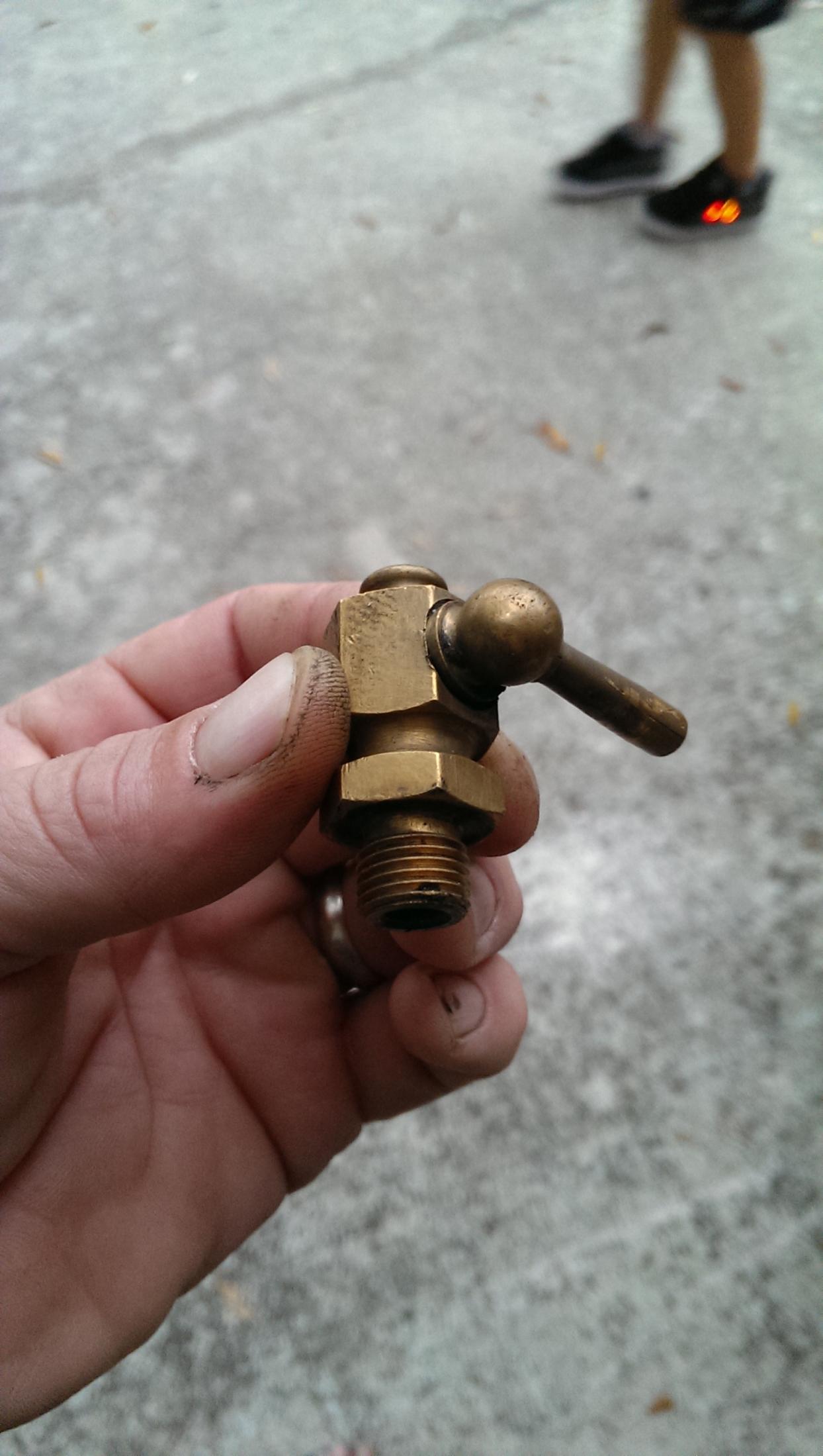

TR2/3/3A anyone know what this valve is and where it goes on a TR3a?
2billydavies

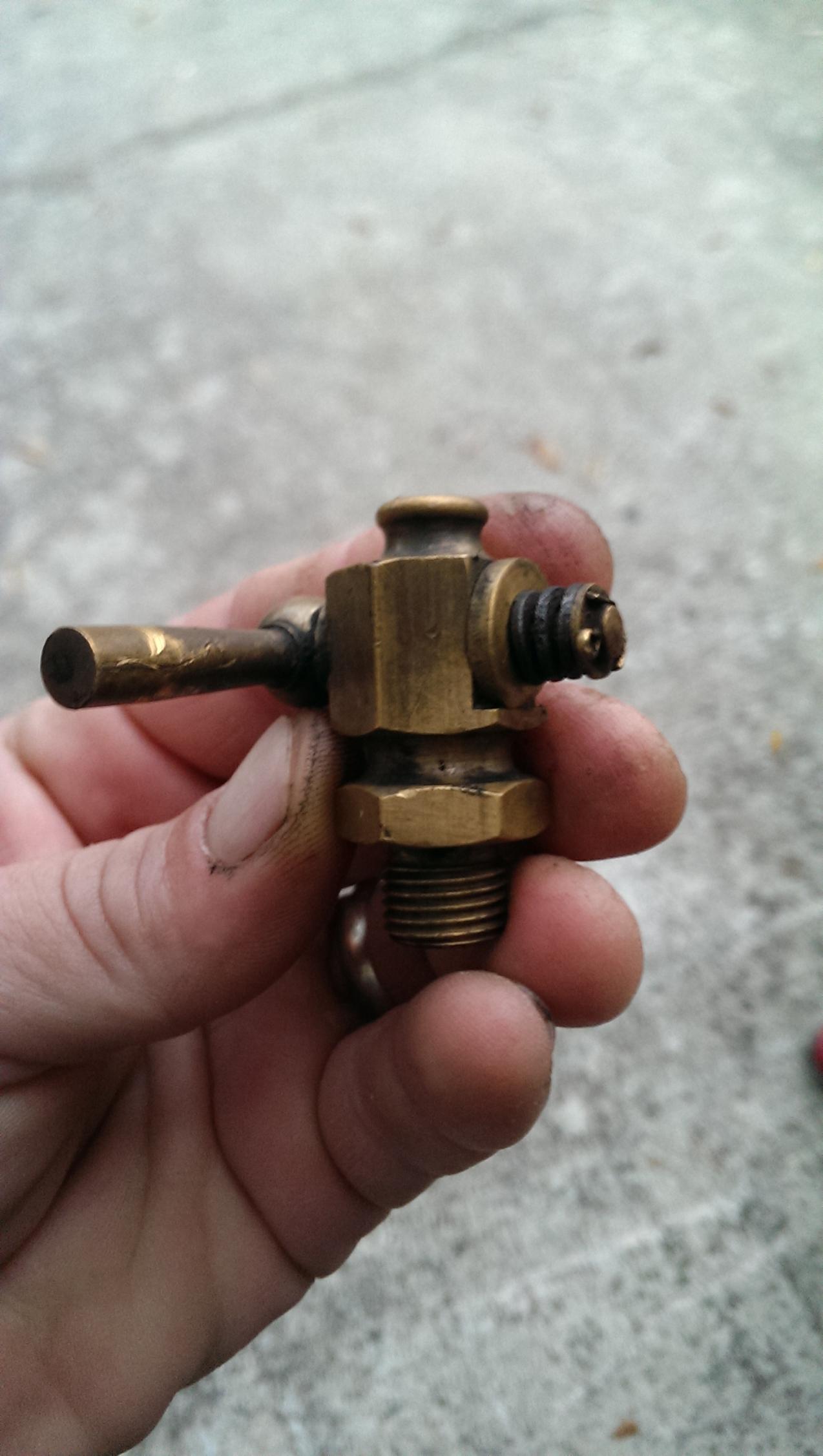

was going through a small box of parts, and came across this brass valve. I have no idea where it came from or where it goes on my TR3a. Anyone have any idea? Thanks!
There is a spring inside the tap which keeps pressure on the taper fitting and is supposed to make it not leak. Most of the time, that is true.
Jerry
The spring is on the outside, and visible in the photo.
What I can't tell is whether the threads are tapered or not. If they are tapered (pipe threads), then it might be the radiator drain tap instead of the block drain tap.
thanks guys.... definitely not the radiator plug. completely different size and design. i'm going to check out the area around the oil filter. i have no clue where it came from other then on this car somewhere. thanks for the ideas/starting points!
