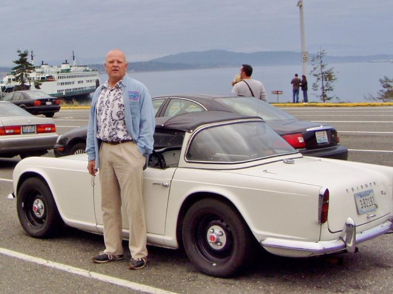

I have some pics of my tr4 with 6 wheels. Problem is the wheels are black so it is hard to a real good look. Didn't have one of just the car, which would be better.
Hi Mark, thanks for the follow up. Well I'm really surprised but maybe it's just me but they look like a different profile in the picture you posted. (be clear, I'm not doubting whether or not you know what size tires you have on your car. Grin) Any issues with rubbing or things like that in your experience?

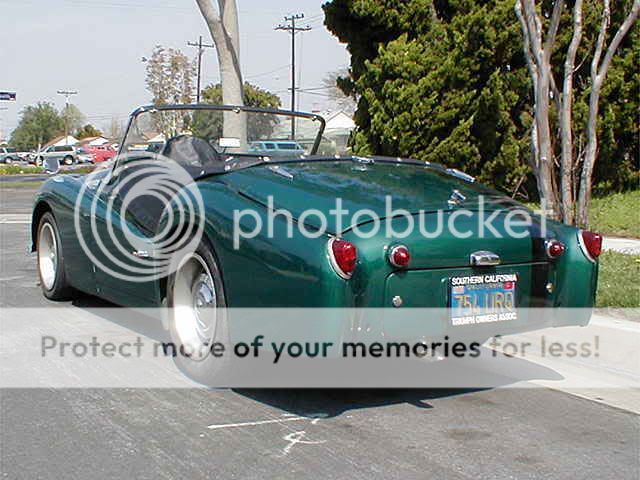

Oh yeah, FWIW, here's a shot of my old TR3A wearing (as I recall) 195/50 on the front and 185/65 on the rear; both mounted on later TR6 wheels (with studs added to carry the TR3 hub caps).
They are definitely 195's, I have 205's on 6" VTO wheels now. I should have bought some 5.5" alloy wheels and stayed with the 195's. No problems with rubbing with either wheel or tire combo.
P3170007compress.jpg~original
Randall - do you remember how the studs were added? I'm running 185's all around on TR6 rims on my TR3A. Would really like to have hubcaps again!

It takes more than just the studs, as the wheels don't have the flat spots where the studs go. I've been thinking about trying to machine some myself, as one of the wheels got bent and the replacement doesn't have them (yet). What I did originally though, was just tap some holes 1/4-28 and screw in bolts with a short sleeve under the head (cut from 1/4" id steel tubing I had laying around) and a drop of Loctite. Then I used an angle grinder to round and shape the heads. Kind of hokey, but it worked well; I've never lost a hubcap (although the factory TR6 trim rings have popped off a few times on really big bumps).

FWIW, here are some 205/55 tires (the size I eventually decided I liked best) mounted on the same wheels (but on my 'new' TR3). They clear everything most of the time. I was having a little trouble with them rubbing on the rear fenders in hard corners, not enough to damage the tire but enough to polish up the sidewall; but that seems to have been corrected with the new rear spring. On the 3A, I had to turn the steering stops in a bit to keep them from rubbing on the ADDCO sway bar; but I don't have it on the TR3 yet.
