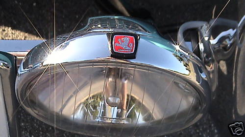

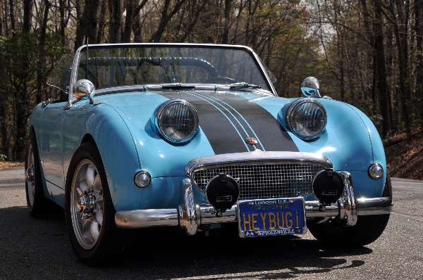

Mine are some NOS Lucas. One is a fog the other is a driving light. The driving light is a pavement melter.
They are attached with some small "L" shaped powder coated brackets. A hole is drilled into the bumper to attach the bracket on the front of the bumper. A relay insures 12 volts to them. A small pressure switch is located on the driver's side interior tunnel up near the dash and lights to alert the things are on. The snap on covers also have a little window so
you can tell if they are left on by accident.
Closeup pic is the pavement melter.
:jester:
I can take some closeups and measurements of the brackets
tomorrow if you need 'em.

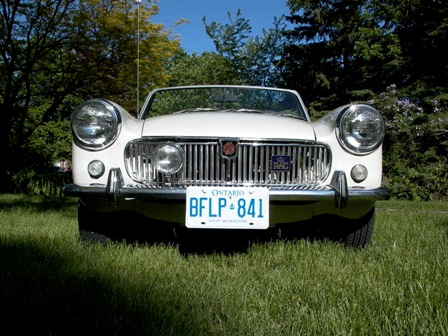

Mine is attached like Bill's is - piece of flat stock attached to the bumper bolt.
Mine is switched through the wiper stalk - it is the same stalk as the MGB where the forward/backward motion switch is for the overdrive. It also runs with a relay.

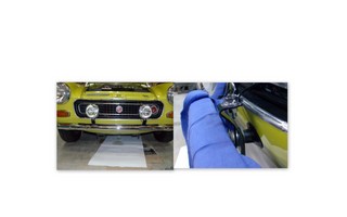

When I was looking for lights, I didn't want them too big. I found these 5" Wipac lights at MiniMania. They have small, push in bulbs, not the H4 type, but are still quite bright and light up a long way. I made brackets out of flat steel and mounted to the bumper supports similar to Bill. Not sure if you can see the detail in the pictures. (The blue towel is to block the reflection in the bumper.)
