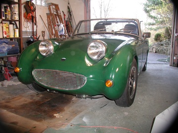

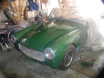

Hey I painted Bugsy in January in Ohio using Rustoleum thinned 50% and a foam roller. Technique works amazingly well and with some buffing can shine up nicely. Technique is to build up successive layers allowing paint to outgas, paint to be smoothly applied with a real light touch, allow paint to dry 20 minutes, and then go back with an extra light touch to smooth out and runs or drips. Fairly good shine even unbuffed and touch up is a breeze. If primers is good and sanded smooth, in 4 days = 4 coats you could be in Rustoleum BRG. Looks really good on Bugsy.Total cost pack of 6 superfine cabinet grade finish 4" foam rollers, handle, Pint of Mineral Spirits, Quart of Rustolum < 25.00. Here is a picture of Bugsy, before BE Bonnet, after 3 coats of Rustoleum. No not a showroom shine but pretty good even from 5 feet. Google Rustoleum Paint Job for other details and testimonials.

Wow Jim, Bugsy looks really good in those pics. That's what I'm talking about. I just need to get my car into some color if I stand any chance of selling it. Right now I already stand to lose <span style="font-style: italic"><span style="font-weight: bold">thousands</span></span> of dollars selling it so the last thing I need to do is put too much money into paint. Every dollar I spend now is just money I'll never see again. Oh well, I guess that's what makes it a 'hobby' and not a 'job'.
But if that's what a paint job looks like from a January in Ohio I should be able to get something reasonable done in Oregon! Thanks!
