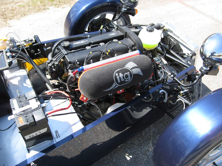

I use one on my Super 7 but, not on the Bugeye. Super 7 is fuel injected, spit backs are seldom. Unfortunately, elements are not available from ITG. Filters have to be replace as an assembly and they are not cheep!! SU's & DCOE's are prone to be cold nature and will spit back during the warm up so, I use a K & N on the Bugeye.

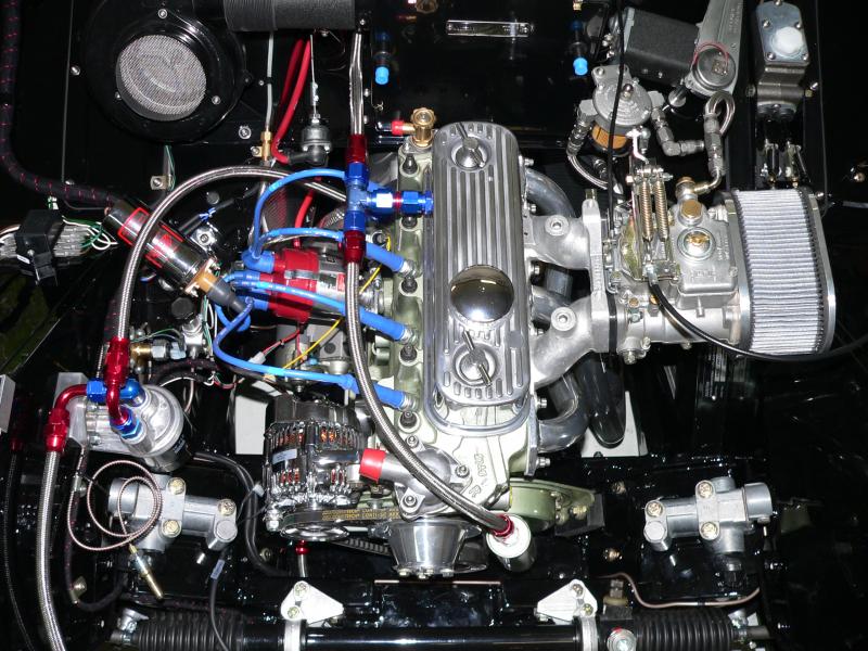

Question for you Bluemax--hoping no one will mind if I ask something that has nothing to do with the filter question.

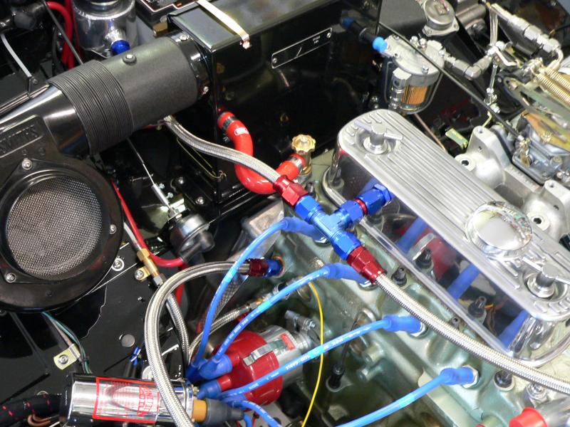

What a gorgeous engine bay, I guess that it is in your Bugeye. It appears that the hose that goes from the timing cover can tees off to the rocker cover, and then it disappears as it gets to the back of the engine bay. Where has it gone? What does it attach to?
Thanks
Charlie
Thanks Charlie, the hose off of the timing cover and valve cover runs to the oil catch tank. You can see from this photo the catch tank in the top LH of the photo.
