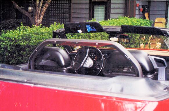

I was looking for a screen for my Sky but attached is a picture of a screen in an allante. They made a frame and attached it to the b-posts(rear upright post that the door lock is attached to) I like the frame its in. Sorry no 6 pics yet.
not a great shot ill try to take another pic of it before the end of the weekend... /ubbthreads/images/graemlins/england.gif

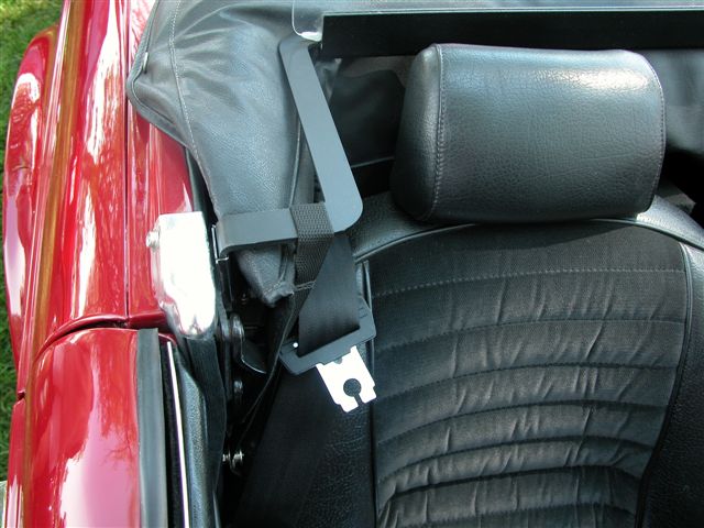

I recently attended a show and took these pics. The windscreen was bought in Britain, it was easily removed by removing material straps which were snapped onto a fastener. the bracket was screwed into one of the flat head screws on each side.
Her is another view. The first flat bar separates from mounting assy as well as the windscreen assy. I would think something similar can be fabricated.I too will attempt this project when time permits.
