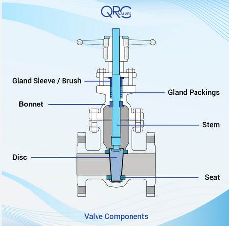

We have these to shut off our services, called a gate valve,
Good for one reason only and that is, they do not restricked the flow when they are open.
Bad news is they have a bad habbit of the rod when turned leaves the gate behind,
I have been cought a few times, turning the water off with this and then it not turning back on..
