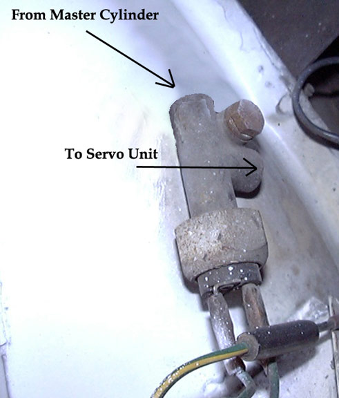

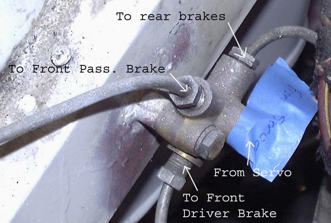

Hi Rich,
Here are two photos of how my valves were plumbed.

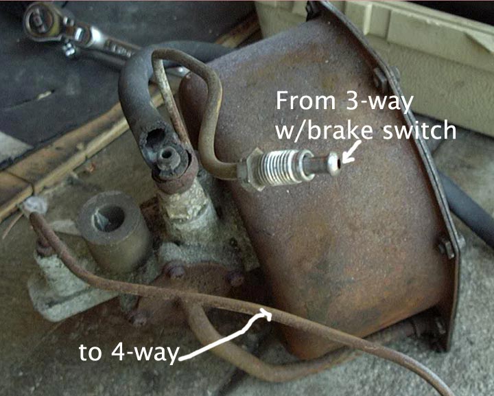

Thanks Greg. Any pictures of the servo itself showing how it is mounted and where the figure 8 rubber piece goes?
I only have a shot of the original booster out of the car. I lost my early engine compartment photos in a hard drive crash. I just marked where I think the brake lines go, but it has been 11 years since I took it out. If someone could verify, that would be great.
I'm using a PBR booster now and it is plumbed differently.
