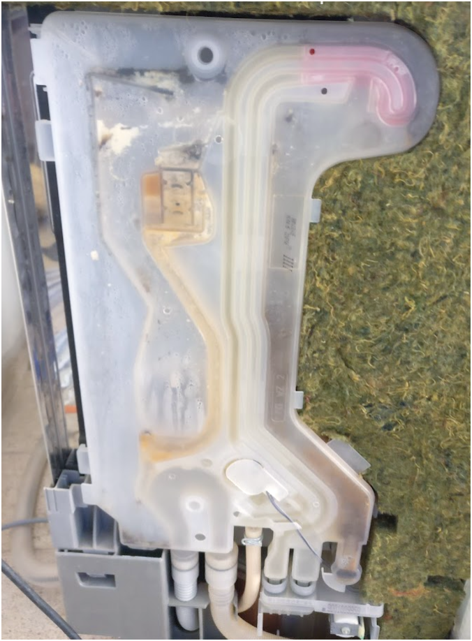

After chasing down a leak for about 3 weeks, I finally found that this thing was causing the leak because it was plugged up.
Left side of Bosch dishwasher. It is called the "water inlet" but obviously does far more than just let water in.
Interesting that none of the appliance repair sites even suggested looking at it.
Anyone know why there is some sort of air vent on the side of the dishwasher venting into this thing? That thing also has a venturi which pulls out water using the outlet pump.
Also out of curiosity why the super complicated passage way to let the water into the dishwasher?
Some of the complication is because of the built in water softener, but it would seem so much easier to send water directly from the water softener to the inlet without this complicated inlet thingy
Heaven knows what's inside that maze of channels, but I'd think an air vent would be needed to prevent "vacuum lock" of the liquid as it's sucked/pushed through the channels.
The super complicated passages may (?) pass over sensors which determine the speed and pressure of the liquid in a specific part of the gizmo.
(My highly inexperienced, total guesswork thought, anyway.)
There is a water flow sensor that little wire goes to the computer. Preventing vacuum lock may be the reason, but not sure why it would come from in the chamber. I was actually thinking of vacuum lock but the other way.. to make it possible to open the door. Still this thing seems really complicated.
It's actually put there for a reason, a simple piece of hose or pipe connection you can get from the hardware store for pennies, that part will cost dearly and can only be had from the manufacture! Oh, plus shipping! :devilgrin:
