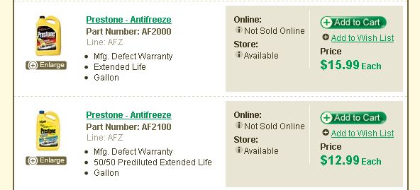

Andrew Mace said:
From my recent experience, the price difference between the 50/50 "premixed" and straight antifreeze is roughly the same as the cost of distilled water, so....
If that is the case, then by all means go for it.
But I just checked the O'Reilly web site: in my area, Prestone "extended life" is $16/gallon while 50/50 is $13/gallon. So that half gallon of water costs about $5.
Last time I bought RO filtered water in a store, it cost $.30/gallon (but I had to bring my own jug :g)
